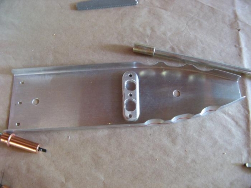

Horiz Tail: Prep HS frame for riveting
* Shimmed tip ribs on both sides to make them parallel to skin pilot holes.
* Drilled up pilot holes to #30 size and clecoed.
Shim to straighten tip rib
Clecoed frame ready to rivet
