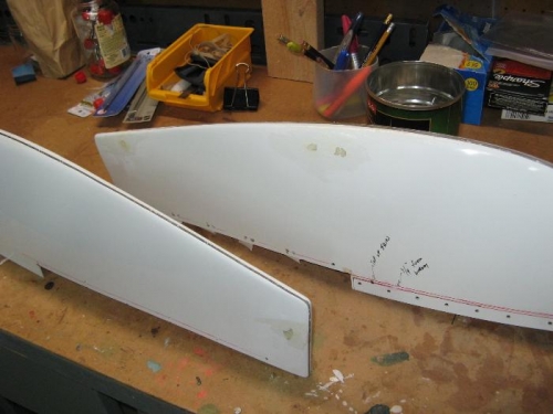

Brief Description:  Horiz Tail: Epoxy work on fiberglass tail tips
* Used 2 part epoxy with microballoons to fill in imperfections along seams joining the two halves of each tip, to fill in badly drilled holes, and to fill several air pockets between gel coat and the fiberglass.
* Had to sand and repeat several times over different days to get desired smoothmess. Time shown is estimated total time.
Epoxy work on horizontal tips
