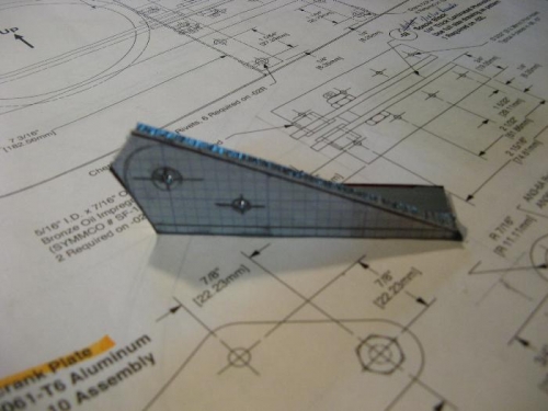

Brief Description:  Wings: Remaking W21-06/07 Angles
The original W21-06/07 Upper and Lower Angles were not drilled correctly, so I am remaking them. This time, I am using tracing paper and pattern cement to transfer the shapes from plans to raw angle stock. I will drill the pilot holes before cutting to shape to provide more surface for clamping back to back.
Rough cut, pilot holes drilled
Drilling to final size, back to back
