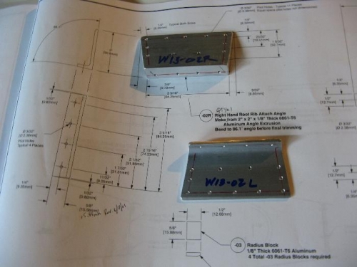

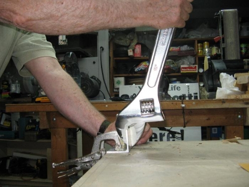

* Fabricated Root Rib Attach Angles W13-02L and -02R from aluminum angle stock
* Fabricated (4) W13-03 Radius Blocks
* Smoothed and edge-dressed laser cut parts: (2) W13-04 Doublers and W13-01R/01L Attach Plates; and (4) W18-03 Cover Plates
Bending Angle
