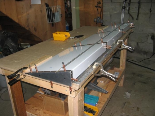

Brief Description:  Flaps: Attach RH Flap Hinge (clecoed)
* I had previously drilled all the hinge stock
* Now, drilled and attached hinge to RH Flap Skin with clecoes.
* Finished deburring and RH Flap is now ready to rivet.
To avoid any twist, I cleco all ribs in place before drilling hinge holes.
Ribs clecoed into position before drilling hinge pilots
