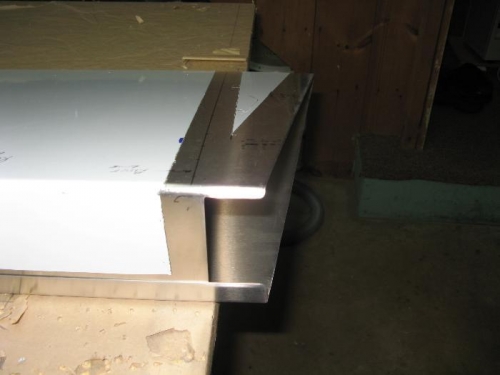

Trimmed inboard end of RH flap

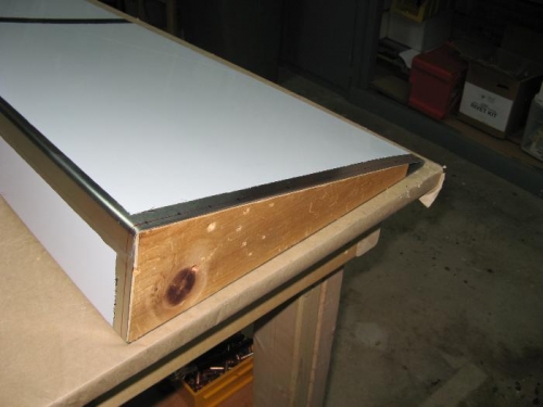

Wood
Wood "rib" for drilling pilot holes
