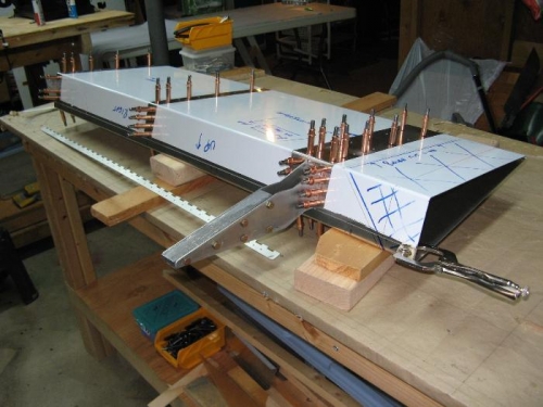

* Measured, drilled and deburred skin to install the Counterbalance Assembly.

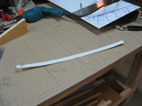

* Made a "rib puller" out of scrap pieces off of stabilizer fiberglass tips to reach inside aileron and pull rib tails into position.
Simple "rib puller" tool.
Clecoing aileron
Counterbalance Assembly in place, holes deburred.
