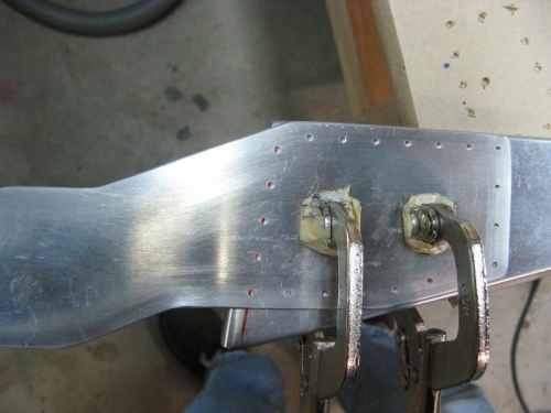

My advice is, follow the plans advice and start by clamping the lead counterbalance between the plates to line things up before drilling. I did this first one backwards. It came out OK, but was a lot harder to get things squared up. I ended up clamping the lead weight in place everything eventually fell into place.
Drilling first plate to rib

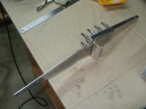

One side drilled and clecoed
Trying to line up second side for drilling
