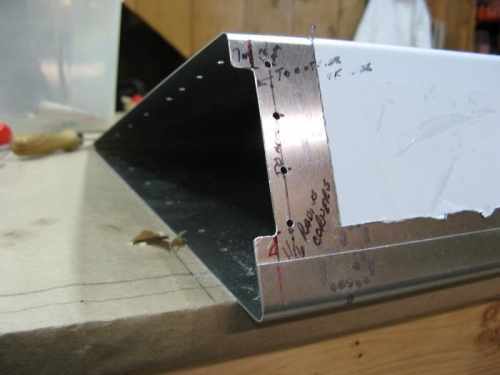

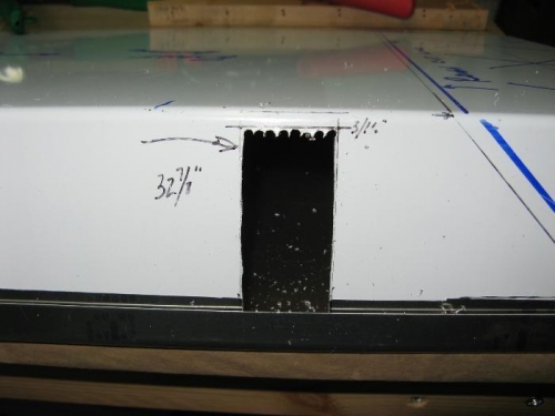

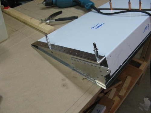

* Drilled middle and inner ribs on RH Aileron, and trimmed out the Drive Horn and Counterbalance openings in the skin.
* Started work on assembling the RH Counterbalance Assembly.
Drive Horn notch
Drive Horn Assembly in place
Drilled across top, used snips on sides, filed smooth.
