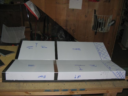

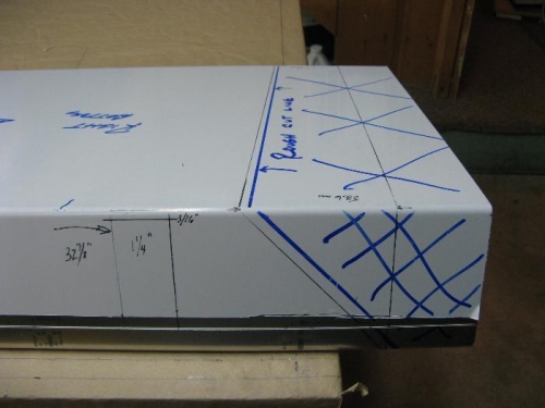

Mark up aileron skins for trimming
* Dimensioned and marked both Aileron Skins (W04-01 R/L) in preparation for trimming and drilling.
Marked up aileron skins
I plan to drill for hinges with ribs in place and BEFORE trimming the outside ends to avoid any twist.
