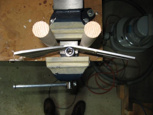

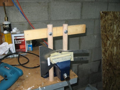

* Made a "pole brake" and bent 3/16" thick Forward Spar Attach Fitting T12-07 in vise to 35 deg.

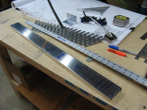

* Completed Forward Spar Channel T12-08.
* Cut rough lengths for T12-03, T12-04 and T12-05. Used band saw for the first time.
Using Dick Gent's
Using Dick Gent's "pole brake" idea to bend Fwd Spar Attach Fitting
Another view. See Dick's brake plans on SonexPlans files section.
