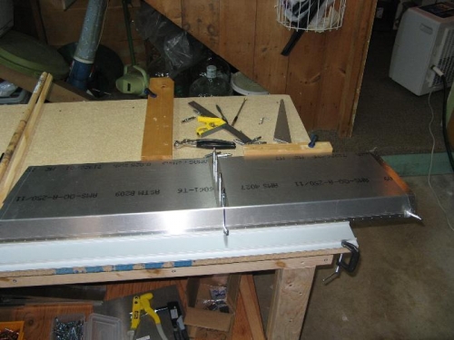

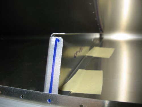

Drilled #40 pilot holes in rudder ribs. Taped center rib into position and drilled it first.
Center rib taped in position inside skin
One side drilled
Still looks square
