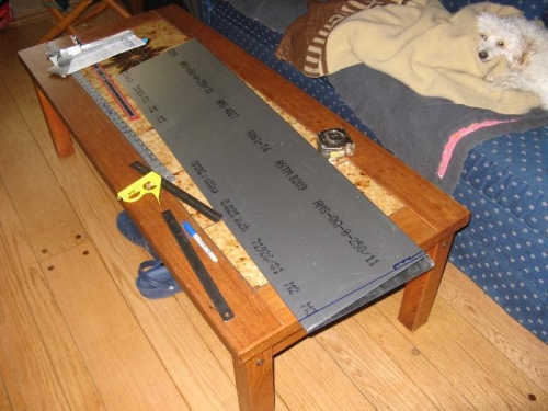

Setup and adjusted new Craftsman bandsaw. Waxed cutting table.
Cut Rudder Skin T13-01 to shape:
Laid out the cut lines on the rudder skin bottom and made the cuts with the Andy snips. Tried the WISS left and right hand snips, but found they scratched the interior of the skin. I need to practice with them. Used a hacksaw to cut the sharp bends before using the snips.
