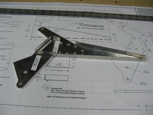

* Brought all "T" section parts to the work area.
* Went through plans to list out all hinge pieces to be made.
* Made T10-06 Upper Hinge Half and T10-07 Lower Hinge Half.
* Started Rudder Drive Horn T13-03.
Rudder Drive Horn pieces
