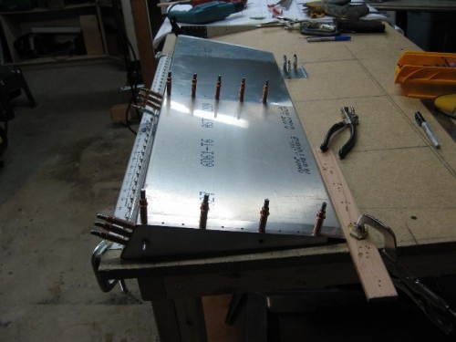

Brief Description:  Right Hand Elevator - Completed
12/08/2008 3.5 hrs Drilled Right Elevator skin, deburred edges, drilled middle rib.
12/09/2008 3.0 hrs Drilled end rib, mounted hinge, drilled up to #30 rivet holes.
12/10/2008 2.6 hrs Deburred and riveted. RH Elevator half. It's finished except for attaching to El;evator Root Assembly (T06-02). Very happy with the way this one came out.
Installed center rib first
Stabilized to table for hinge drilling
Root rib to be drilled later; positioned to hold skin up while drilling hinge
