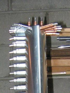

Brief Description:  Vertical Stab Skin: Updrill, debur, tip rib pr
* VS Forward Spar upper flange is not quite long enough. Pilot holes into tip rib forward end went into the bend. Not very strong and pinches the skin inward so the fiberglass tip will not fit. I'll need to reorder the tip rib from Sonex and lengthen the flange.
* Sent an email to Kerry Fores with my plan to make an extension and rivet it on.
* Drilled up to #30 rivet holes and mostly finished the deburring.
Pinched skin at the top
Misaligned tip rib
Misaligned tip rib
