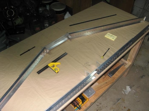

1.0 hrs. Papered over workshop table and laid out pencil lines for assembly of Horizontal Stabilizer frame.

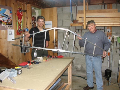

3.0 hrs. Craig Ritson came over and we assembled the HS frame (drilled #40 pilot holes and clecoed ribs in place except for tip ribs. Flanges on both ends need to be adjusted to position tip ribs properly.
TIP: It's extremely important to position the spars exactly and clamp or cleco them down to the table.
Laying out lines on paper
Note Craig's scuba diving
Note Craig's scuba diving "bean bags" for holding ribs in place for drilling
What two can do in a couple of hours!
