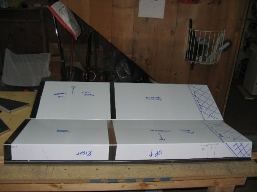

Brief Description:  Ailerons: Marked up skins
* Dimensioned and marked both aileron skins in preparation for trimming and drilling.

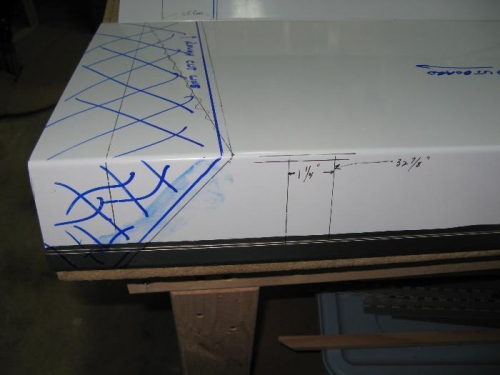

TIP: I plan to drill the hinges before trimming the outer edges. That way, I can use the W04-02/03 Aileron Ribs in the middle and both ends to maintain skin alignment from end to end and hopefully avoid introducing any twist, while keeping the hinge perfectly straight. Had some trouble with this on the Left Elevator hinge.
Marked up ailerons
Marked up ailerons
Willl use snips to rough cut and file to the exact dimensiointo avoid the ripple effect from snips.
