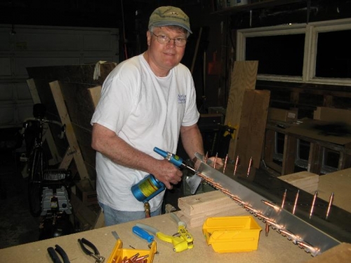

* Assembeld and riveted the Rudder. Had problems with the pneumatic rivet gun - seems to not work when a rivet stem doesn't eject. I started with 45 lbs pressure and increased it to 60 lbs but it doesn't seem to matter much. Finished the job with the hand riveters. Afterwards, found many marginally crooked rivets which I'll have to redo.
* LESSON: INSPECT EACH RIVET AS YOU GO.
First time using the pneumatic riveter.
