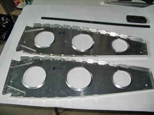

Brief Description:  Wings: Started SNX-W16 Aft Wing Ribs
Completed Aft Wing Ribs #1 (W16-1R and -1L).

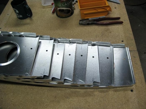

Completed marking up and notching Ribs #2-#5 Right and Left. Used unibit to drill radii, bandsaw to rough cut notches, files and Scotchbrite pad and wheel to finish notches.
Aft Ribs #1 R and L
Aft Ribs #1 R and L
Aft Ribs #2-#5 R and L notched
