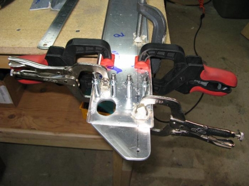

Finished up Right Hand Rear Spar and began work on Left Hand Rear Spar.
Aligned Attach Plate with chord line

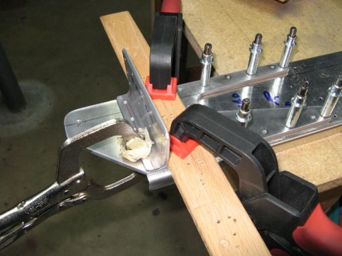

Clampled wood piece to align angle piece for drilling
Boltsand spacer in place
