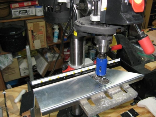

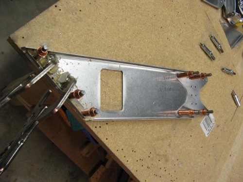

* Drilled spar channel for Detail H - Splice Attach Plate
* Drilled channel and made hole for Detail E - Doubler
* Drilled for Detail F - Rib Attach Angle installation
Hole cutter used to start rectangular hole in tip

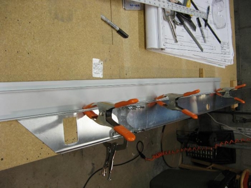

Spar channels held straight for Splice Plate attachment
