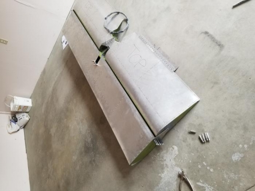

Brief Description:  Mounted Hinge brackets onto the stabilizer
I ensured proper alignment of the Horizontal Stabilizer and the Elevator control surface, and mounted the hinge brackets onto the Horizontal Stabilizer with Clecos. I will not permanantely rivet the hinge brackets in place on the Horizontal Stabilizer until after it has been mounted onto the fuselage in case removal of the Elevator is required.
Ensured proper alignment
Drilled/Clecoed hinge brackets in place on stabilizer
