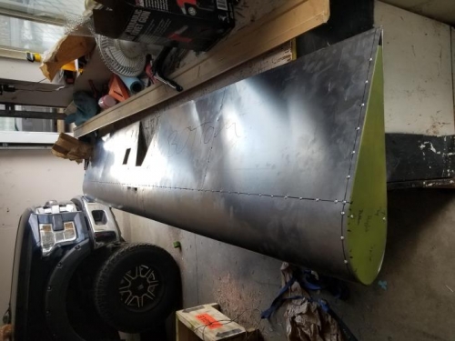

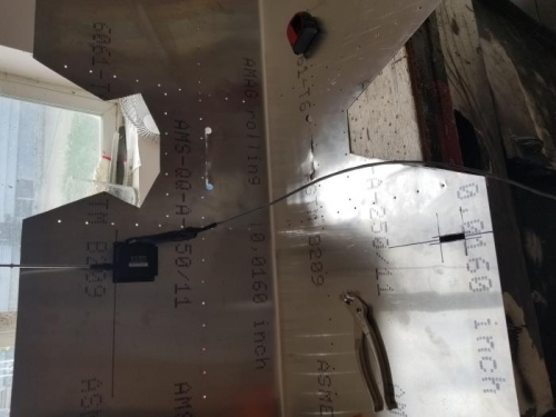

Brief Description:  Made cutouts for electric trim actuator, reassembl
I marked out and made the cutouts for the electric trim actuator, the connecting rod for the actuator, and the access panel for the trim actuator. I then reassembled and riveted the elevator skin onto the elevator skeleton.
Drilled and clecoed the elevator trim acuator in place, cut out slot for actuator rod
Cutout hole for access panel
Reassembled and riveted the elevator skin on the skeleton
