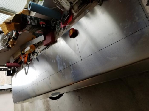

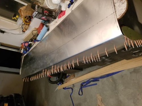

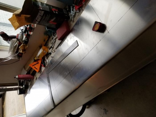

I marked out all of the rivet locations for the bottom skin on the skeleton, and drilled out the pilot holes before fitting onto the skeleton and clecoing in place. I then flipped the structure over marking out and drilling pilot holes for the rivet locations on the top side of the skin.
Marked spar/rib locations
Marked/drilled pilot holes for rivets

Drilled/clecoed bottom skin in place, and marked out rivet locations for top skin
