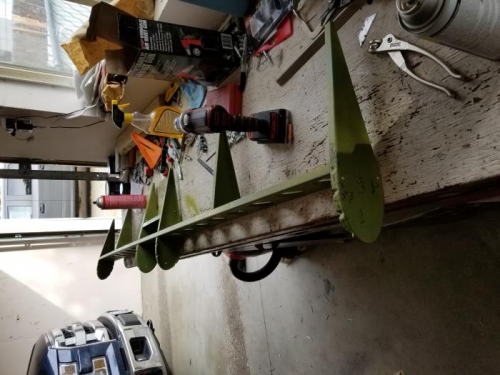

Brief Description:  Added rear elevator support, finished elevator ske
I drilled and clecoed the rear elevator support between the two inner most rear ribs on the skeleton of the elevator. I then removed all components of the elevator and deburred/corrosion protected. then I reassembled and riveted the structure together, completing the construction of the elevator skeleton.
Deburred, corrosion protected, and riveted skeleton together
