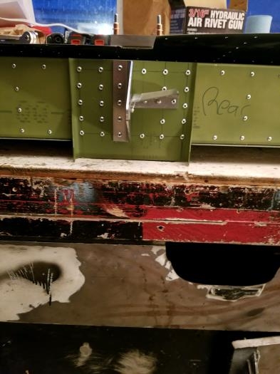

Manual Reference:  Hori. Stabilizer
Brief Description:  Fabricated hinge bracket and gusset, rivited brack
Using the predrilled holes on the hinge bracket, I drilled/clecoed it into palce. I then took the gusset for the hinge bracket and mounted it with the bracket clecoed in place. With both the hinge bracket, and hinge gusset clecoed, I rivited all of the rear brackets in place.
Fabricated hinge bracket to spar
fabricated hinge bracket gusset to hinge bracket
Mounted hinge bracket, rivited all rear brackets
