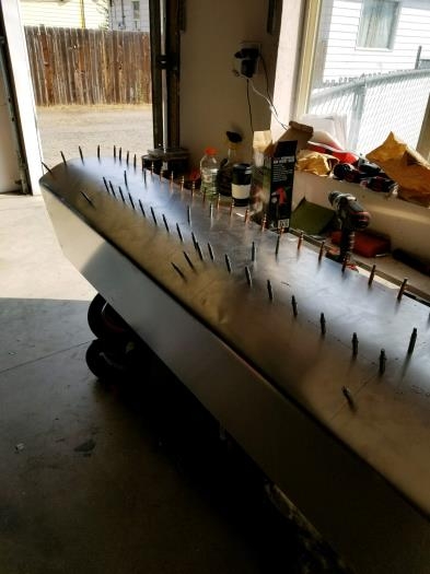

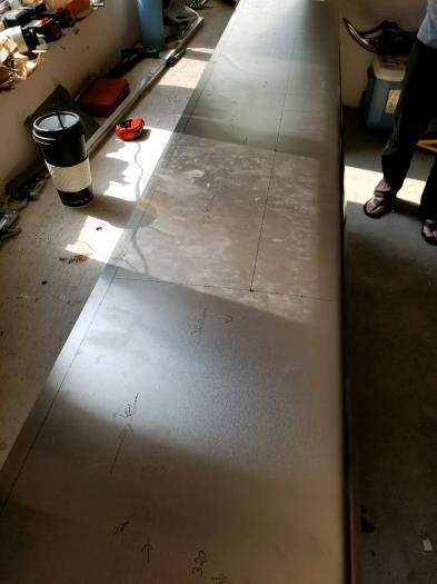

I marked out all of the rivet holes on the bottom of the stabilizer skin, and drilled out the pilot holes. Then I laided the skin on the stabilizer skeleton and drilled/clecoed in place.
Rivet marks and pilot holes drilled on bottom of skin
Skin clecoed onto the skeleton
