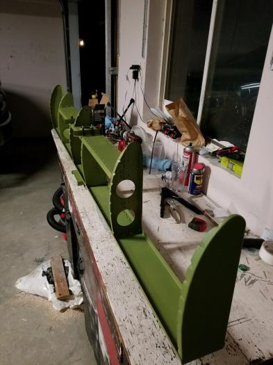

Manual Reference:  Hori. Stabilizer
Brief Description:  Debured/Painted/Final Assembly of Skeleton
I disassembled the completed skeleton, and debured all of the rivet holes. After deburing, I painted the metal with a Zinc Chromate aersol, used to inhibit corrosion. Finally, I reassembled the skeleton in its entirety, and rivited everything in place with the expeption of the mounting brackets. The front and rear mounting brackets were left clecoed in place and will be rivited in a later step.
Debured and painted to prevent corrosion
Reassembled and riveted skeleton togeter
