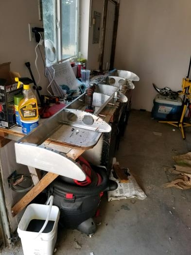

I positioned/drilled/clecoed the outer ribs to the front spar, making sure to cleco to the rear spar before drilling the L-bracket ensuring proper alignment of ribs. I then positioned/drilled/clecoed the endcap ribs to the rear spar.
Joined outer ribs to front and rear spar
Joined endcap ribs to rear spar
