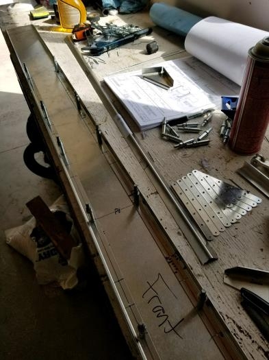

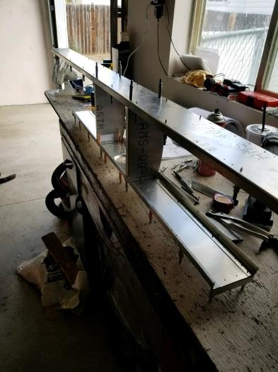

Brief Description:  Added doublers, joined front and rear spars
I marked out the locations for all of the rivet holes on the doublers for the rear spar, and then drilled/clecoed the doubler into place. With the doublers clecoed, I joined the front spar and rear spar together, drilling and clecoing in place.
Marked rivet locations on doublers for rear spar
Drilled/Clecoed doublers in place on rear spar
Drilled/clecoed front spar to rear spar
