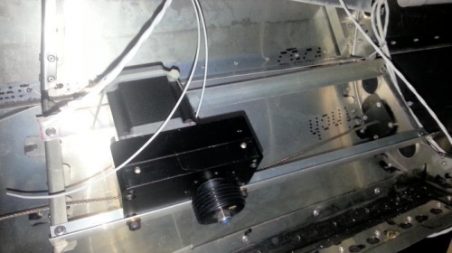

Brief Description:  Second Autopilot.
SO i found a way to mount the second autopilot motor, its position is right under the ibox on two aluminum L profiles.
This setup wont interfere with the fram since it only will turn a wheel and not excert any momentum on the ribs.
i also tried to find a position so it wouldt affect the compass when activated, that was 3feet minimum.
