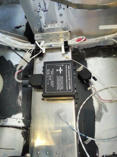

Redid the flaps sensory, it looks better.
Prepared for wiring to the front.

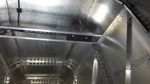

First i placed the Compass and Gyro up in the rear, where i wouldn’t get any magnetic interference, the position was bad for the gyro since it need to be in the center of gravity point, then it hit me, the gyro and compass don’t have to be at the same place, so i moved the gyro to underneath the seat leaving the compass in the back alone.
