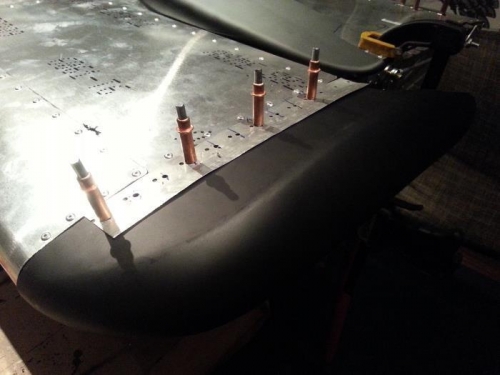

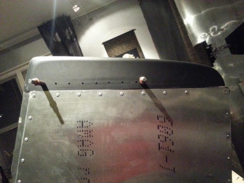

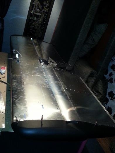

Brief Description:  Mounting of plastic tips.
This was probably the hardest so far, the plastic tips were uneven and all of them needed some grinding to get a good fitment so i could get more straight edges.
Im not satisfied to 100%, i hope it will look allot better when the parts gets some paint later on, which as of, i havent decided what its look like yet.
I have to say thanks to my friend "Hans" for giving me the tamplet so i quickly could drill the holes on the tips, made it allot easier, ive already given him a Whisky for the inventory list =), can i pamper him more?
I Also attached the plastic tip for the fin temporarly untill i get my Aveo engineering Positrobe MiniMax, which reminds me i need to buy some cable, 20 AWG 3 wire shielded.
The plastic over the trim on the left side has rivnuts so maintence is easier, also bought some really nice M4 allen-screws.
