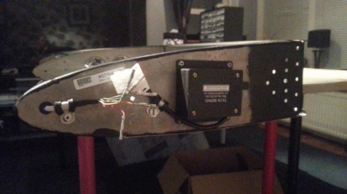

Assembly of the Trim-motor was easy, the hard part was how to get the tiny cable there, ran away bought some clams and then find a good way to the middle, hopefully i will also soon get the assembly instructions for the electric pins.
Instructions for mounting the NoseUP cable SC300 is very unclear, there are plastic plates the need to be mounted on the skins, but it dosent say inside or outside of skin.

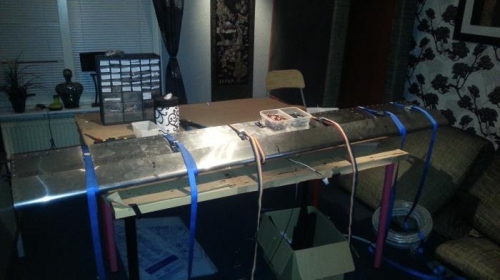

When fitting the nose skin its very hard to get the rivets in even if i use ALLOT of clecos, some tinkering is a must, like loosening a few clecos to slide in a rivet and force it there, its a miracle that i didnt sheer anything.
