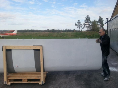

Ok so i got the Aircraft primed, what a load of work, not to be kidding of, many days, and i had quite a drive to get there, 120km one-way.
First MEK/thinner the whole aircraft, then rub it with Alodine 1201.
I used Randolph aircraft Coating, probably not the cheapest but damn it looks good, three thin coats to form one covering coat, first try was a bit thick but the rest was perfect.
I must give my gratitude to my Friend Hans Marchner for letting me sneak in my aircraft in his paint booth when he had painted his, so i helped him finalize his plane and then he painted my stuff in rounds.
