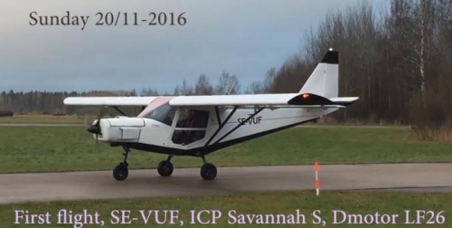

First flight of the Aircraft has happenned and at the time of writing 2018 i have flewn 26 hours.
Video of first flight you can find here, https://youtu.be/PTojgcdBmio
First flight ended quickly when i blew the alternator fuse, that resulted to change into a bigger battery 18aH. a few flights after that i had som ECU issues that made me land without engine power twice safely at the base.
Ecu was replaced to Dual ECU in Belgium and now that works, after that i had a valve guide loosen, that was also fixed in Belgium.
I see that as a part of testing a new aircraft, since then i have done 20 hours flight,
Cruise speed is 74 knots, a few more knots wouldnt hurt.
