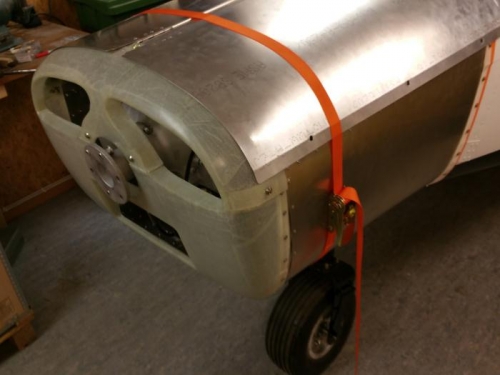

Cowl adjustment

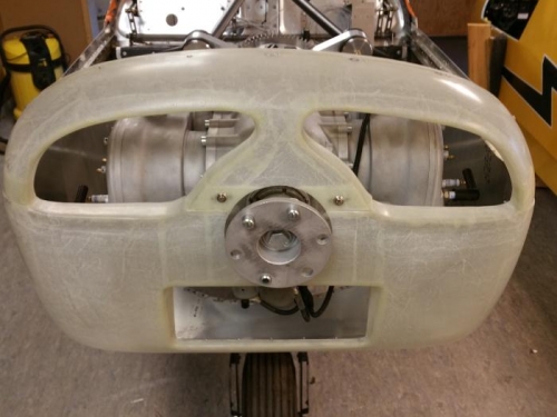

Lined the cowl up and got the rivnuts there.
Allot of work. line it up drill the new holes, remove cowl, enlarge holes, rivnut it, put it back on and screw it there, line up for next holes and repeat.
Hood was also too long, marked up and will take to a shop for cutting.
