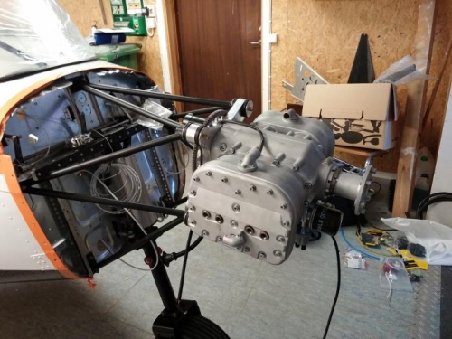

Engine mounting.

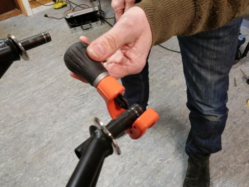

The engine mount points were shortened with this magnificent tool and the mount spacers was left to a machine shop and enlarged.

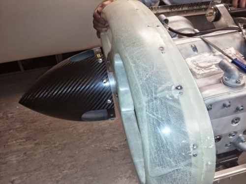

Cowling was shortened allot to make the prop flange extrude.
This had some shortcommings as the oilfilter and oil temp sensor now protudes allot.
