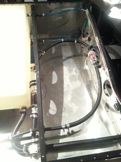

In the photo on top theres a blue hose, its smaller than the ordinary, but i had serious issues geteting the ordinary 8mm hose into the smaller 5mm hose, so i changed it on both wings,
Also changed some other hoses that i thought was 8mm when mounted in Right wing but it wasnt.

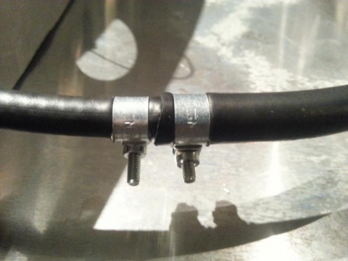

Today i also got the new clear Fuelfilters so i could finaly assmble system, filter was 8mm iD so had to make a coupling from the 5mm to a 8mm, i simply cut off the enlargment form the old fuelfilter that had a 6mm & 8mm step and used it.

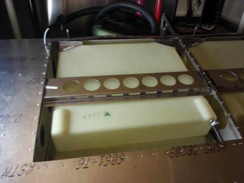

Also i mounted Rivnuts around the inspection hatch, this was a pain in the ARSE, they were so fragile, i had to redo several of them. Rear part has countersunken rivnuts and side has ordinary rivnuts wich makes them a bit taler.

New blue Level Hose.
Step up in size.
Rivnuts.
