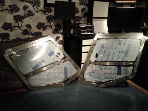

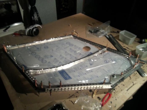

Ok Right door done and while i was at it i also did the left door in another 4 hours.

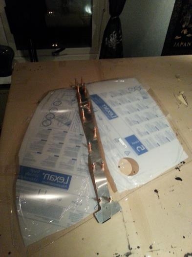

I used another method for assembly on the left door, started with the middle rib that was already formed, after thar i added the lexan and outher plate, and voila i had the basic form in ½ the time.
after this it was just to add the pieces in a circle and cleco them, went allot better, still you needed to do first door the original way to understand were all the pieces was supposed to go second time.
Fitment is still perfect.
Also found a fault in the manual fro ICP, they wrote 2550mm for the parachute handle, looking further into to it with ICP they said atleast 1600mm, i ordered a 1700mm.
Right door.
Right door.
Middle rib first this time.
