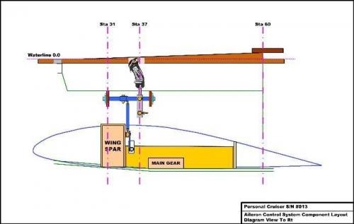

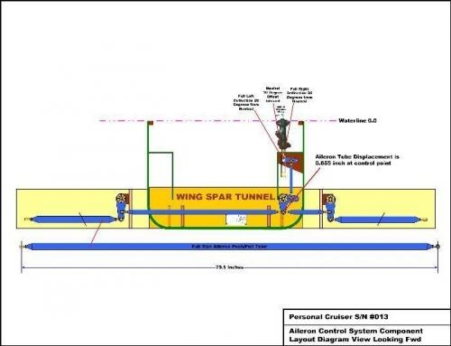

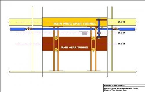

Brief Description:  Aileron Control System Design
The aileron control is basicly stock from the Vision 2-place aircraft with modifications in the cockpit to utilize a side stick controller. The placement of the landing gear tunnel in the fuselage beneth the seat precuudes the standard routing of the elevator push-pull tube along the centerline and thus the redesign. Note that all components unique to the aileron system are shown in Blue. That is a color coding system they will be painted to so that it is obvious as to what system they belong.
Side View
Side View
Top View
Top View
Aft of Main Spar View
