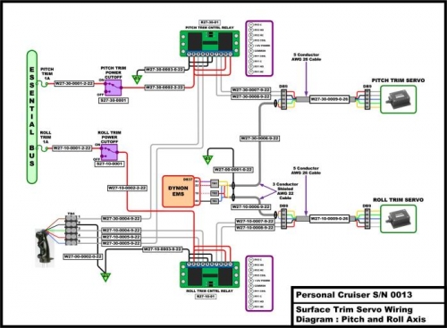

Brief Description:  Flight Control SurfaceTrim
The trim for the flight controls consists of a trim servo mounted in the Left Elevator and the Right Aileron. Control for those trim tabs is done through the typical coolie hat switch located on the stick grip. For Rudder trim aservo mounted on the firewall between the rudder pedals which shifts the neutral point in their travel. Control is done through a rocker switch on the left side console in front of the throttles. A RAC trim indicator is located right above the switch to indicate what the trim setting is..
Pitch and Roll Trim Schematic
