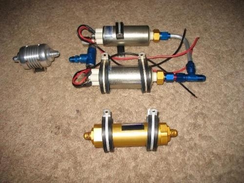

2) These are the pump and filtering components that go on the firewall. The golden cylinder at the bottom center is the 100 micron fuel filter that came with the FI system. Before that component will be an Andair gasocolator which also has a 70 micron filter element but I was not confident that it would be as through as
