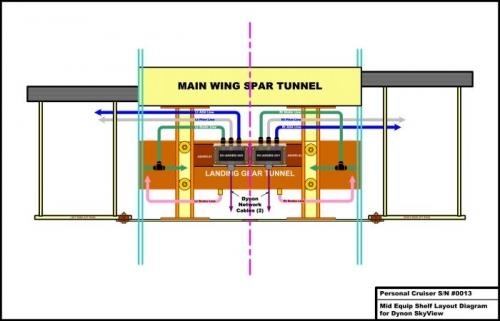

Brief Description:  Mid Avionics Shelf Layout
The mid body avionics shelf has provisions for two Dynon AHARS units driven by two separate pitot/static systems. This is located under the seat on top of the tunnel for the main landing gear tunnel. This design is just a provision and assumes that the eventual panel design requires this hardware.
View from Above
View from Above
