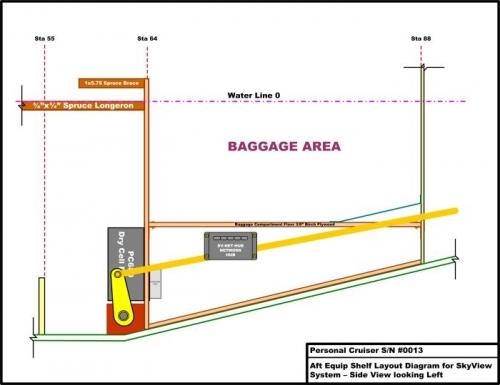

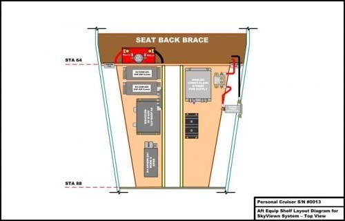

Brief Description:  Aft Avionics Compartment
The aft avionics shelf is split in two on either side of the tunnel for elevator push-pull tubes. The left side is mostly avionics and the right side is electrical and exterior lighting. This is located below the baggage compartment and has cooling fans to ensure that the components do not overheat during warm weather.
Top View
Top View
View from Left Side
View from Left Side
