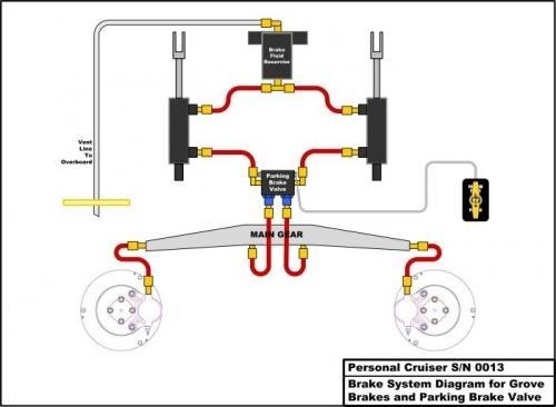

Brief Description:  Basic Design of Brake System
The brake system is conventional hydraulic utilizing Grove components throughout. A small reservior is attached to the upper firewall below the horizontal shelf that mounts electrical and ignition components. A parking brake valve is included in the system and is mounted to a longitudinal shelf that extends from the forward firewall shelf back to the instriment panel base structure. A push-pull control is located at the extreme right of the instrument panel sub panel. Pulling the parking brake knob out to the stop will lock the brakes to their current pressure so the pedals must be depressed firmly prior to setting.
1) This is the schematic for the brake system, nice and simple.

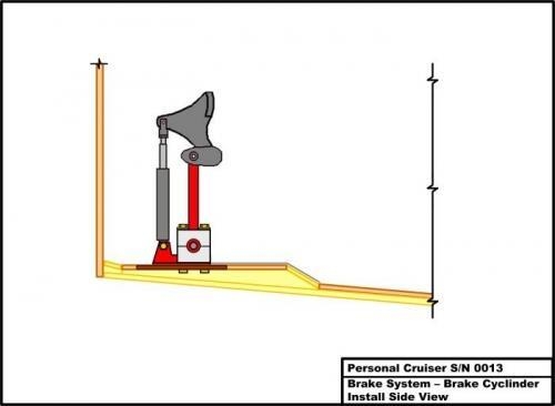

2) Side view of the forward fuselage showing the layout of the floor mounted brake components and rudder pedals.
