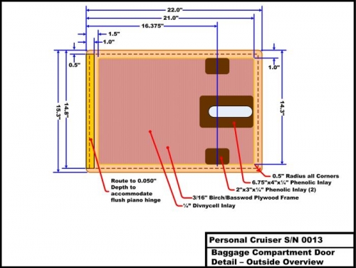

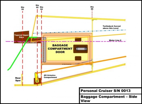

The stock Cruiser has very little baggage compartment provisions as the fuel is conatined in a large tank behind the seat.Since I am using the 2 place Vision wings with internal fuel tanks this area has been freed up for storage. To make access easier I am adding a door to the left side on the part of the fuselage that is flat. The floor is hade of removable plywood panels and below are compartments that contain remote mounted avioncs and exterion lighting components as well as the ELT. The tunnel for the elevator push-pull tube is also below the baggage compartment and a raised fairing is added near the aft end of the baggage compartment to provide extra clearance without the need to raise the entire floor. The door is hinged at the forward and a latch / lock will be provided at the aft edge
Side View of Baggage Compartment and Door

Baggage Compartment Door
