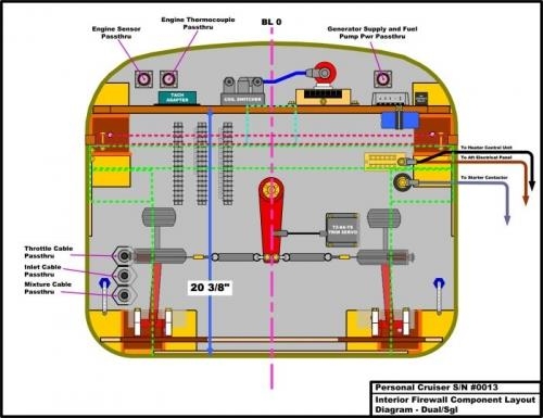

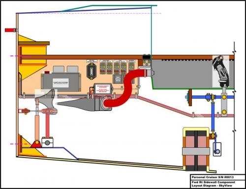

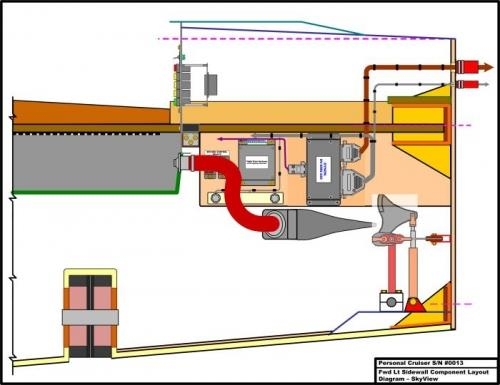

Brief Description:  Fwd Cockpit Component Layout Design
There are a lot of components that need to have a place reserved for them in the forward fuselage. These components are a mixture of electrical system, avionics, brake system, ignition system and flight controls. It is a lot easier to work it out on paper first rather then just starting to hang them where ever you find space and discover at the end you have a mess in the cockpit.
Firewall - Interior View
Fwd Left Sidewall
Fwd Left Sidewall
Fwd Right Sidewall
Fwd Right Sidewall
