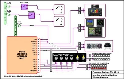

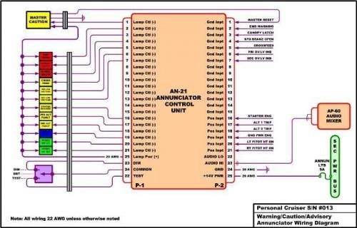

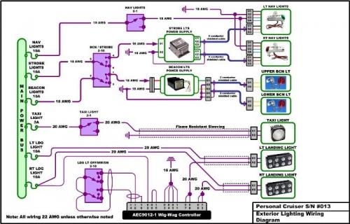

Brief Description:  Aircraft Lighting Design
The aircraft will feature a full range of Interior and Exterior lighting to all Night operations. All the various warning, alert and advisory signals are connected to a central controller with Master Warning and Lamp Test capabilities. Both the interior Lighting dimmer and the WCA controller are supplied by Flight Data Systems. The flasher for the Wig-Wag Landing Lights is supplied by Bob Nuckolls of the AeroElectric Connection
Interior Lighting Schematic
Warning Caution and Advisory (WCA) system schematic
Exterior Lighting Schematic
